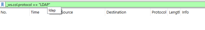

Configure the 2nd ethernet port to "mirror", connect a pc an start wireshark to sniff phones traffic. Then post filtered trace (ldap).
LDAP trace:
Yes, ZERO LDAP packets :) Phone do nothing. RTP,SIP packets are sent do PBX, but no LDAP packets :(
